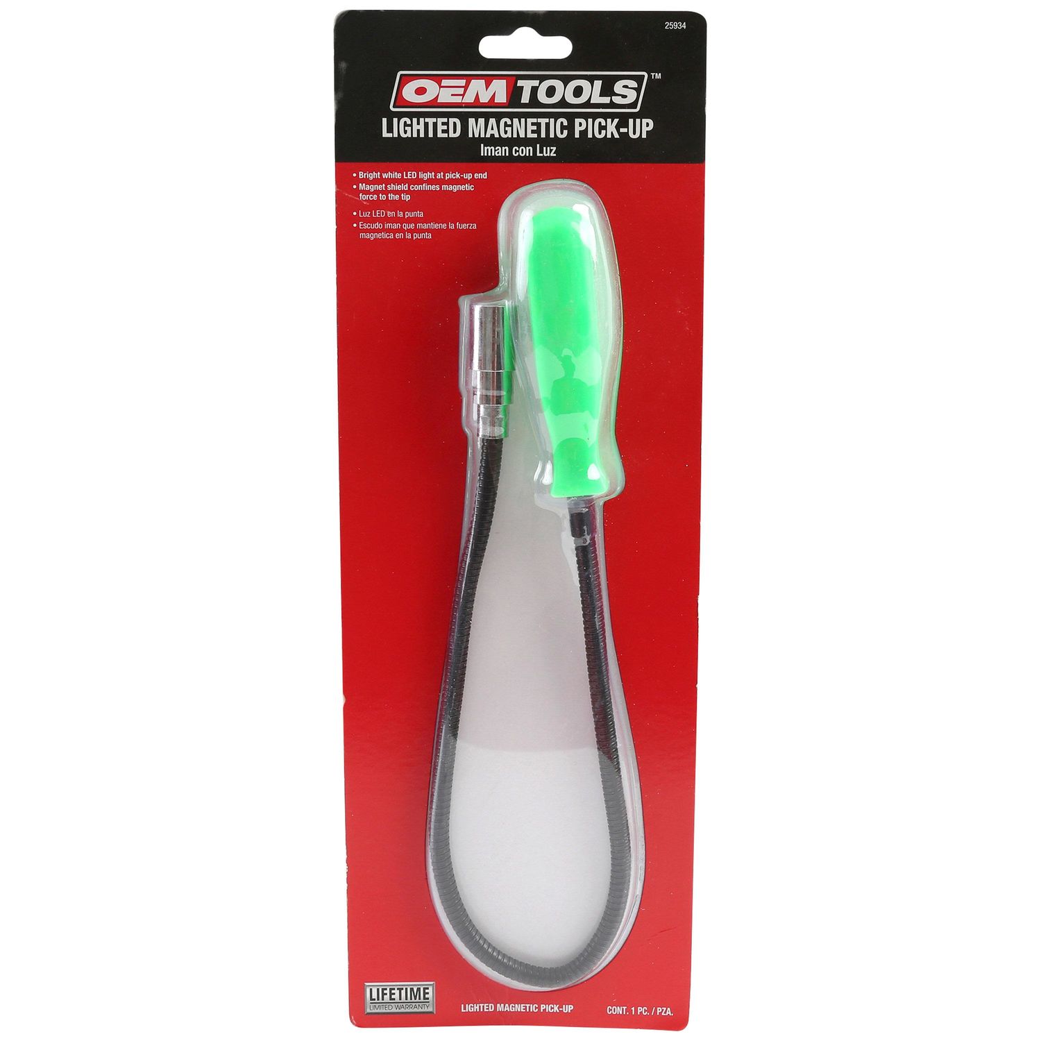

I have a couple of those magnetic pickup tools mrbigstuff. Yes, they are useful but I don't think there's enough room to maneuver. Likewise for vice-grips, pdq.
