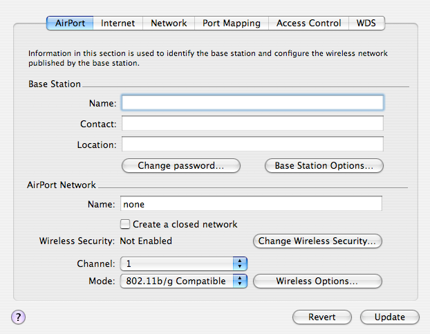

Go into Airport Admin Utility then Configure. You should see a selection for "Mode" at the bottom of the window. Make sure it is set to 802.11 b/g compatible.

Thanks so much-I found it in Airport utility when setting up manually(could it be I don't have Airport Admin on this Mini? I see it on the iBook but not on the Mini... maybe I need to grab that from the CD?). It was already set to b/g.

Well, if it is set to b&g, then I would guess that it is a problem with the encryption. If it had been set to g only, (airports can be set up to do b only, g only or b & g) then that could have been the problem.
I would suggest taking the encryption off and see if it connects with the network open.
